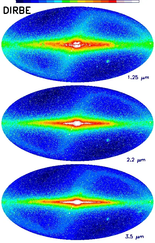

Let me see if I can provide some examples of the general background (not including small-angular-size sources like planets and individual stars). These are all-sky projections in Galactic coordinates, so the disk of the Milky Way defines the "equator".
For the shorter wavelengths, I'm using observations from the Diffuse Infrared Background Experiment (DIRBE) instrument of the COBE satellite. [Source] The first images are for the shortest wavelengths (shorter than "thermal IR"): 1.25, 2.2, and 3.5 microns. These are dominated by emission from stars in the Milky Way, though you can see zodiacal light concentrated near the ecliptic plane -- this is the backwards-S-shaped curve of diffuse emission. For 1.25 and 2.2 microns, this is sunlight scattered by dust grains in the inner Solar System; at 3.5 microns, there's an equal contribution from actual thermal emission from the dust grains.
