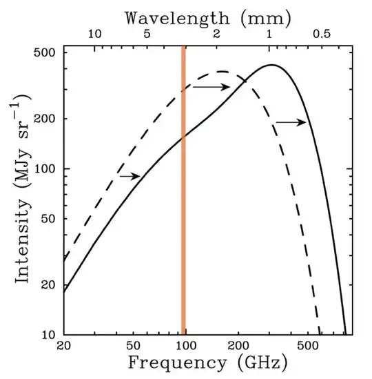

Calling it a "temperature decrease" is kind of misleading. (Possibly this is a side effect of the tendency to use "brightness temperature" in radio astronomy to mean measured intensity.) It's actually an intensity decrease in the 95 GHz band used in the observation. This comes about because the thermal Sunyaev-Zel'dovich effect tends to shift the photons to higher frequencies, but doesn't change the number of photons, so that the number of photons at frequencies below about 218 GHz decreases (and the number of photons at higher frequencies increases).
This figure shows the basic effect (I've indicated the approximate frequency of the ALMA observations in orange.) enter image description here Exaggerated thermal S-Z effect. The dashed curve is the original CMB spectrum, while the solid curve is the shifted spectrum. From Carlstrom et al. (2002).
Thus, you see lower 95 GHz intensity inside the cluster (solid curve), relative to the unmodified cosmic microwave background outside the cluster (dashed curve). If you actually measured the full spectrum, you'd see that the spectrum inside the cluster corresponds to a higher temperature, as you expect.

  • Yes this seems to explain it nicely, thanks! Had they observed at say 500 GHz (not sure they could at the time) there would have been a brightening and it would have been a larger effect perhaps, but there could be other reasons why 95 GHz was chosen. Thanks! – uhoh Jan 30 '22 at 22:26
    This plot shows that the atmospheric transparency at 500 GHz is less than half that at 95 GHz... – Peter Erwin Jan 31 '22 at 23:17
  • ALMA is above most of Earth's atmospheric water, does that plot represent sea level? update: Yes it seems it does! :-) Looks like that's for a precipitable water vapor of only about 1 mm (1, 2) – uhoh Jan 31 '22 at 23:27
