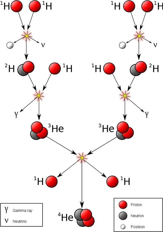

Here's a diagram from the Wikipedia article on the proton-proton chain, showing the main p-p I branch:
p-p I branch
That article gives this reaction (quoted from Iliadis, Christian (2007), Nuclear Physics of Stars)  for the deuteron production, including the electron-positron annihilation:
$$\rm p + p + e^- \longrightarrow {}^2_1D + \nu_e + 1.442\,MeV$$
The annihilation releases $\rm 1.022\,MeV$, so the proton-proton fusion itself only produces $\rm 0.42\,MeV$. That energy is released as the kinetic energy of the reaction products, i.e., the deuteron, positron, and neutrino. (Of course, the two protons also provide some KE). Because of momentum conservation, most of the KE goes to the leptons (the positron & neutrino) because the deuteron is almost 1900 times more massive than they are. As is typical in $\beta$ decay events, the energy and momentum are randomly distributed between the leptons. I can't find a diagram for the energy spectrum, but I expect that it is similar in shape to that of neutron decay, which is shown in this Physics.SE answer. Also see this question about the difference between the spectra of $\beta^+$ and $\beta^-$ decay.
The total mean energy released by p-p fusion, averaged over the various branches, is $\rm 26.73\,MeV$, so the $\rm 0.84\,MeV$ released in creating the two deuterons is only ~$3.14\%$ of the total.
