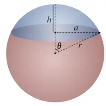

Suppose the orbital revolution axis of the planet is pointed directly at us, the observer. Then, we would be perfectly perpendicular to the orbital plane and there would be no transit. Instead, from our perspective, the planet's orbit would be perfectly circular at a distance of $4d$ from the star.
Only when the orbital revolution axis (along r in the below image) was some angle $\theta$ from our line of site (along h), would the planetary orbit cross the star from our perspective. The revolution axes where no transit exists could be projected onto a unit sphere as a spherical cap, with area $A = 2\pi (1-\cos{\theta})$. The area of a unit hemisphere is $A_h=2\pi$, so the fractional area of no transits (which is the probability of no transits) is simply $P(\sim t)=A/A_h=1-\cos{\theta}$. Image credit wikipedia
The angle $\theta$ is simply the complementary angle of the maximum transit angle, so $\theta=\cos^{-1}{(1/8)}$. So $P(\sim t)=1-1/8$, and the probability of a transit is then $P(t) = 1- P(\sim t)=\frac{1}{8}$.

  • "The angle θ is simply the complementary angle of the maximum transit angle,..." is difficult to follow. The "maximum transit", if it is defined as the transit with longest time, would it not be with θ =90°? in your convention for θ. In this case the non-transit cap is defined by that max θ that results in the minimum transit time (the planet just touches the star disk w/o entering it). Did I miss something? – Ng Ph Jan 17 '22 at 19:29
  • @NgPh Sorry I was late with this reply. In the figure in your answer, my $\theta$ is the same as $i$, Since cosine is the Adjacent over Hypotenuse of a right triangle, $\cos{\theta} = 1/8$. The maximum transit angle is the (complementary) unlabeled interior angle. – Connor Garcia Jan 18 '22 at 16:34

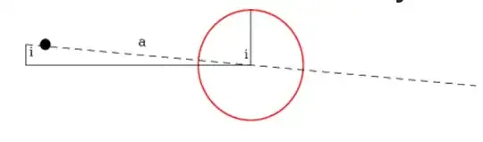

The reasoning in (4) computes Pt as the probability Prob{abs(cos(i)) < $R/a$}, $i$ being the angle that the orbital plane makes with the perpendicular to O-S (see Fig).
enter image description here source

In (1), it is reasoned that, when we increase the inclination angle (called $\theta/2$ in the figure), from 0° (maximum transit), the orbit leaves the transit zone when $sin(inclination)=R/a$.
In (4), it is reasoned that when we reduce the angle $i$ (see Fig) from 90° (maximum transit), the orbit leaves the transit zone when $i$ reaches the value that satisfies $cos i =R/a$.
They are both correct up to this point, but diverges on a (very subtle) mathematical point. In (1), it is assumed obvious that the inclination angle is uniformly distributed, whereas in (4) it is $\cos i$ that is uniformly distributed. We can suspect that the calculation of (4) is correct because the result of (4) matches that of (3). But why is it that saying that the inclination is uniformly distributed is flawed ?
