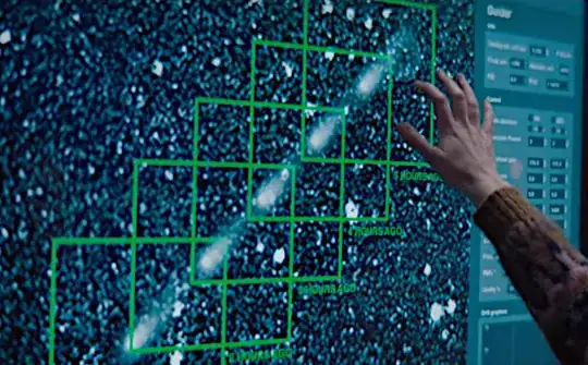

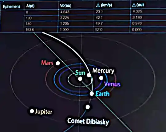

For what it is worth, here are screenshots of the two relevant scenes from the movie. The first one reads "2 hours ago", "3 hours ago", and so on, so they do have some pre-discovery data. This scene however does not show a particularly long history, even though it might be available.
The second screenshot appears to show the comet already inside Jupiter's orbit and traveling on a quite direct path towards Earth. This would make it even harder to determine its orbit, but on the other hand the direct collision course does not match the 6+ month timeline.

    It is never explained in the movie, but I am pretty sure that is what is happening. After having spotted the comet, the protagonist walks over to a fancy "Hollywood" interface, where by tapping on the screen, she makes an additional four sightings of the comet appear. It was my assumption that what this is supposed to represent is her looking up older observations in some magic Hollywood database via some magic Hollywood visual interactive query system. – Jörg W Mittag Dec 28 '21 at 20:17
    When the protagonist's professor and his students compute the trajectory, they have 14 measurements on the whiteboard. – Jörg W Mittag Dec 28 '21 at 20:21
  • @JörgWMittag Heh, inspired by this question I also watched this movie yesterday. A fine comedy, but the science doesn't hold up. I added some screenshots. – jpa Dec 29 '21 at 06:54
