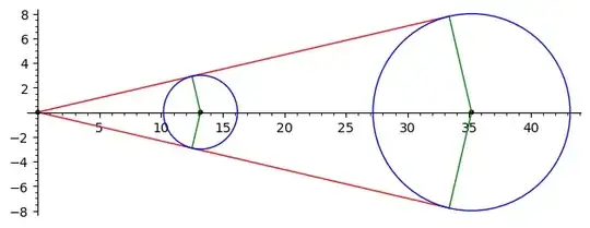

When viewing a sphere of radius $r$ at a distance $d$ from the centre of the sphere, you don't see a circle of radius $r$. The extreme lines of sight are tangents to the sphere, as this diagram illustrates.
Tangents to two circles
A tangent to a sphere or circle makes a right angle to the radius at the point of tangency, so we have 4 similar right triangles. Let the radii of the circles be $r_1, r_2$ and the respective distances from their centres to the origin be $d_1, d_2$, so the (centre to centre) distance between the two circles is $d=d_1+d_2$. Then
$$d_1 = \frac{d\cdot r_1}{r_1+r_2}$$ $$d_2 = \frac{d\cdot r_2}{r_1+r_2}$$
and the angular diameter $\theta$ is given by
$$\sin\left(\frac\theta2\right) = \frac{r_1}{d_1} = \frac{r_2}{d_2} = \frac{r_1+r_2}{d_1+d_2}$$
Using values from Wikipedia for the radii of the Earth and Moon, and their mean distance, we get
Body Radius Distance
Moon 1737.4 82365.8
Earth 6371.0 302033.2
Sum 8108.4 384399.0
with the angular diameter $\theta\approx 2.41734°\approx2°25'$ or $145$ arc-minutes, which is almost $4.6$ times larger than the Moon's mean angular diameter as seen from Earth's surface, which is $31.7'$, although it ranges from $29.3'$ to $34.1'$.

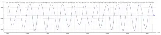

Also, the orbit of the Moon & Earth about their barycentre is moderately eccentric, with a mean value of $\varepsilon\approx 0.0549$, and the eccentricity changes depending on the distance to the Sun.
Here's a daily plot of the Earth-Moon distance for 2020, produced using Horizons.
Earth-Moon distance, 2020
