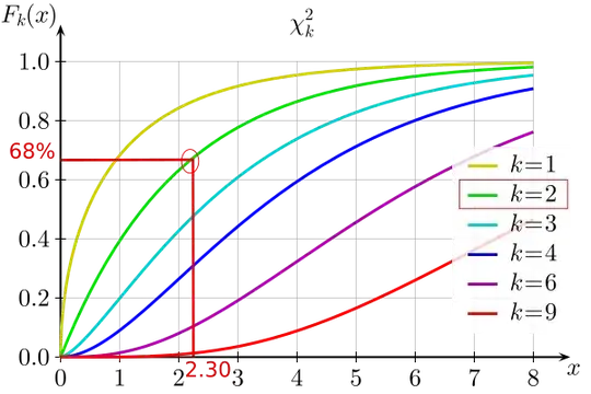

From your comment I would take that you already know how to plot contours in python, but are not sure, at what level/height to plot them to get a 1-sigma/68% contour.
The answer you can find, e.g., in table 1 from this paper: Avni 1976
Essentially, in case of a map of 2 parameters, your $\Delta S = S - S_\mathrm{min}$ statistic follows a $\chi²$ distribution with 2 free parameters. So we want to know how high we have to go in $\Delta S$ to include 68% of this distribution. And if you look that up from the cumulative distribution function: enter image description here
So in conclusiion you will get the 1-sigma contour, if you draw you contours at $S_\mathrm{min} + 2.30$.
