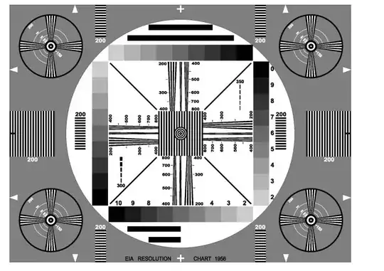

Please look at this TV resolution chart from 1956. It helps to measure the resolution of TV screen. It is made of various fine-detail features, like thin lines spaced apart in progressively smaller distances.
Source: https://www.cctvcameraworld.com/cms/wp-content/uploads/2014/03/resolution-chart.jpg.

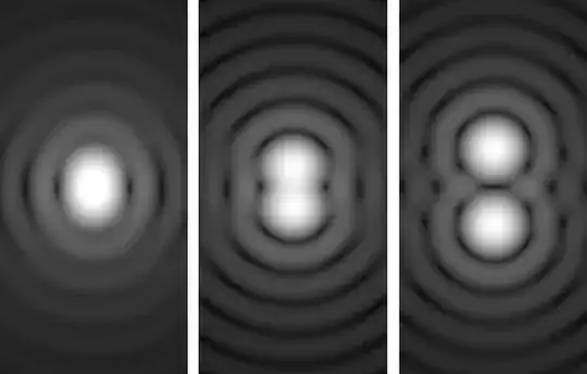

We can always start with the grandparent of all resolution definitions, which is The Rayleigh criterion
Rayleigh criterion
Two airy disks at various spacings: (top right) twice the distance to the first minimum, (middle) exactly the distance to the first minimum (the Rayleigh criterion), and (bottom left) half the distance. This image uses a nonlinear color scale (specifically, the fourth root) in order to better show the minima and maxima. (cropped and rotated from source)
The middle image doesn't look as resolved as it should because the author chose to use the fourth root of brightness instead of a linear scale, but you can see a dark band between the two "stars" in the middle one even in this image.
These patterns are what diffraction from a circular aperture causes, either your pupil or a telescope or your camera's lens. It doesn't take into account your square pixels though, so it doesn't help.

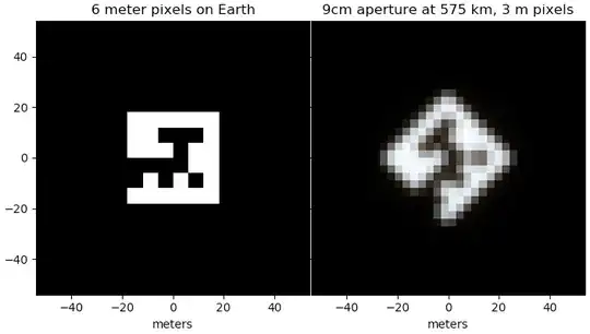

Here's another case in point. It's from this answer to How big would a QR code have to be on my roof for a satellite to be able to scan it given today's allowable resolution? in Space Exploration SE.
"QR-code" on a roof, seen from space
It's the result of a simulation of a 6 meter pixel "QR code" (not exactly) on Earth's surface seen from a 9 cm aperture telescope in orbit 575 kilometers above Earth with the sensor's pixels having a resolution at Earth of 3 meters. I've used an Airy function to simulate the image, the same thing that generates those concentric rings in the first image here.
Resolved? Not?
Perhaps 'barely" or "almost" or "mostly, except for some parts..."? We can recognize that it might be QR-code-ish but from our eye can't
You can see that I was naughty and rotated the image sensor's axis by 45° on purpose just to make it more interesting.
If you gave the right image to a computer program, it could probably recover the data that was encoded into the original "QR code" most of the time, but it might be much harder for a person to figure out.

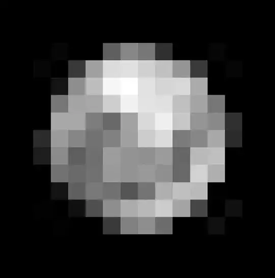

It's up to you really, based on your application. For amateur astrophotographers or lay people like me, I'd say that if other folks look at a tiny few-pixel image of the Moon and recognize it as probably the Moon without being told, then it's resolved. So maybe 10 pixels wide? Is it the Moon? If I told you it was, would it be believable? If I asked you what it was without any hints, would Moon be your first guess?
Resolved? Not?
a 10 pixel Moon
Now if we had a thousand Moons and you had to identify which one? then you might need to go to maybe 16 pixels wide.
