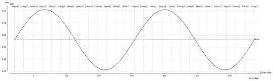

Here's a plot of the Sun-Earth distance, generated using Horizons, for the period 2020-Apr-3 to 2022-Apr-3. The mean (time-averaged) distance over that period is $\approx 149\,619\,270$ km.
Sun-Earth distance
If you want to generate your own plots, here's a live link to my Sage / Python script. There are some instructions on using the script in this Space Exploration answer.
