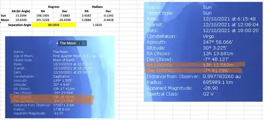

The example below calculates the Sun-Earth-Moon angle and was calculated by getting respective Sun and Moon RA and Dec on Oct 28 (next 3rd Quarter). The angular separation function can be found here.
Note 1: I used Starry Night to get the values shown, which software can also give angular separation directly thus voiding the need to calculate the separation angle.
