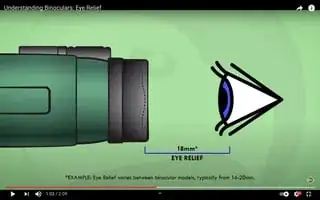

I've always paid attention to eye relief of the exit pupil, which is how far it falls beyond the eyepiece. My reference point here are my binoculars which have large diameter eyepiece optics which allows them to have a long eye relief; passing them back and forth between an eyeglass-corrected vision person and someone without glasses is just a quick rotation of the eyecups to different distances.
But I never looked at the diameter of the exit pupil, as it seems not to be an independently adjustable parameter of the optics; the exit pupil diameter is "baked in" to the choice of objective aperture and desired magnification.

Borrowed from How far are space-walking helmet faceplates from the eyes? How far will I have to hold my "space binoculars" from my eyes during a space walk? :
screenshot from How to Adjust Your Binoculars (Presented by Nikon Canada) screenshot from Understanding Binoculars: Eye Relief
See also Nikon Monarch Binocular Eyecup Repair How-to DIY
What it looks like when you are too far away from the eyepiece. From Wikipedia's exit pupil. If you were looking for something in a field of stars this "tunnel vision" would make it a lot more difficult.
