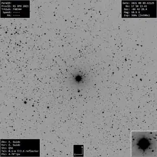

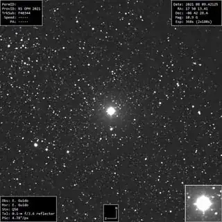

S Ophiuchi OUTBURST
Taken by Ernesto Guido, Marco Rocchetto & Adriano Valvasori on August 9, 2021 @ Remotely from Australia through TELESCOPE LIVE network https://telescope.live recurrent nova RS Oph is in Outburst. The last large outburst of RS Oph occurred in Feb. 2006, →
Question: How can I find or generate a binocular-friendly star map to find the Recurrent Nova RS Ophiuchi?
recurrent nova RS Oph is in Outburst https://twitter.com/mizuho73700856/status/1424718454595092492 recurrent nova RS Oph is in Outburst https://twitter.com/mizuho73700856/status/1424718454595092492

The bright star in the lower left is the third magnitude $\nu$-Oph. Only one of the stars in the astrophotograph in your question is visible, and that is extremely faint.
