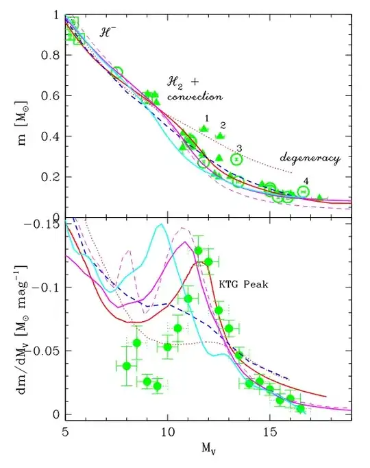

As we get to the lowest masses for hydrogen-burning stars, the luminosity as a function of mass is either discontinuous or nearly so. The derivative becomes either infinite or very large. (From now on I'll just say words like "discontinuous" without the qualifiers.) The following graph, from Kroupa 2002, shows this feature:
The graph has mass on the y axis and M_V on the x axis, so the bad behavior shows up as a horizontal graph (derivative of the inverse function blows up). For more on stars right at the hydrogen-burning boundary, see this article by Lodieu. Figure 1.2 is helpful, showing how the luminosity tracks bifurcate for the two classes of stars. The critical mass for hydrogen burning depends strongly on metallicity, as do temperature and luminosity. For a star with solar metallicity, a star at the critical mass has $M_V\approx 19.5$ and $M_K\approx 11.5$, but these numbers are really sort of ill-defined because one is essentially zooming in on a discontinuity (or near-discontinuity) in a graph and trying to pick off a $y$ value. The way this mathematical ambiguity manifests itself in reality is that $y$ depends very strongly on other factors, such as metallicity.
As we approach this critical mass, the luminosity drops discontinuously, and therefore so does the maximum radius of detection. So if the question is to be well posed, we have to distinguish between two questions. Let $m$ be the mass of the star, $m_0$ the critical mass for hydrogen burning, and $r$ the greatest distance at which it can be detected. Then we have two different limits. There is one for stars,

Looking through the list of nearest stars on WP, we get stuff like M8.5 stars with an absolute J magnitude of about 11.5, per a correction by Peter Erwin. The J band is centered at about 1.2 μm. It looks to me like an M8 is very close to the minimum mass for hydrogen fusion. The WISE survey is a fairly recent full-sky infrared survey, and it used a set of filters called W1 through W4. W1 is centered at about 3.4 μm. Looking at this thesis by Silverstein, usually the W1 magnitudes of cool objects like this are about 1 magnitude brighter than their J magnitudes, so maybe a star like this would have a W1 magnitude of about 10.5. WISE's sensitivity varies a lot in different parts of the sky, but they seem to be confident that they can detect anything with a W1 magnitude lower than 16.6. This gives a distance of roughly 160 pc. This is probably a reasonable estimate of $r_s$.
From Peter Erwin's answer, we know that $r_{bd}\gtrsim 10$ pc, but the question is really asking about $r_s$, not $r_{bd}$.

    It's not correct to say "the luminosity drops to zero" for the low-mass end of the hydrogen-burning main sequence. See, e.g., 2MASS J05233822-1403022, which has an absolute visual magnitude of 20.6 (and a distance of 12 pc). – Peter Erwin Aug 07 '21 at 21:33
    The M8.5 stars in the Wikipedia list have absolute $V$ magnitudes of around 19; their absolute $J$ magnitudes are about 11.5. – Peter Erwin Aug 07 '21 at 21:43
  • @PeterErwin: Thanks for the correction about the J magnitude. That makes a huge difference! Re the luminosity dropping to zero, as I said, that was an idealization. –  Aug 07 '21 at 22:32
  • It's not ideal, it's wrong and simplifies away physics crucial to getting a correct answer for this type of question. It's simplification at best, if you want. Yet there is a minimum mass, and thus a minimum magnitude as quoted by Peter – planetmaker Aug 07 '21 at 23:44
  • @planetmaker how is it wrong? A star that's minimally above the mass limit for burning hydrogen could have an arbitrarily low burn rate. I can imagine stars burning something else (D was mentioned) and fall out of the classification; how about a gen-1 star that is just H and He, barely above the H fusion threshold - could such a star still exist today, with very little other elements picked up so it still burns "essentially just H" but at a really low rate? – user132372 Aug 08 '21 at 08:30
  • @user132372 It's wrong because even brown dwarfs (H burning = 0) have finite sizes and effective temperatures, and thus do not produce zero flux (except in the limit of infinite time for cooling). – Peter Erwin Aug 08 '21 at 10:30
  • @PeterErwin: Thanks for your comments. I've revised my answer to try to clarify my meaning and to clarify why we need to be careful about the definitions. –  Aug 08 '21 at 17:30
  • There's a big difference between detecting some faint IR source and identifying it as an M8 dwarf at 160pc. Both detection and a means of estimating a reliable distance is required. The answer is a lot closer to 10pc. – ProfRob Aug 08 '21 at 21:13
