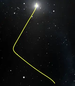

I'm trying to look at what the solar analemma looks like from different planets, using Stellarium. To plot the analemma, I go into the ephemeris tab of the astronomical calculations window. From there, I show the position of the Sun every few solar days.

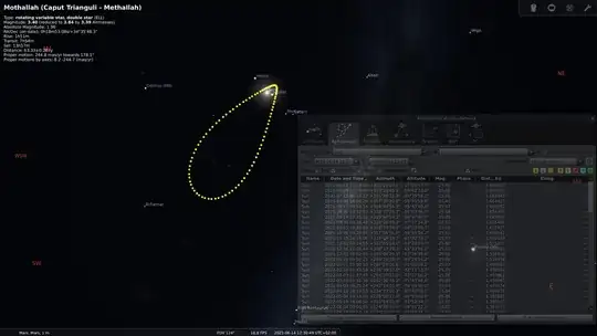

From Earth, the analemma is a well-known "figure 8". From Mars, it's a sort of teardrop shape, because the orbit of Mars is much more elliptical.
the analemma seen from Mars

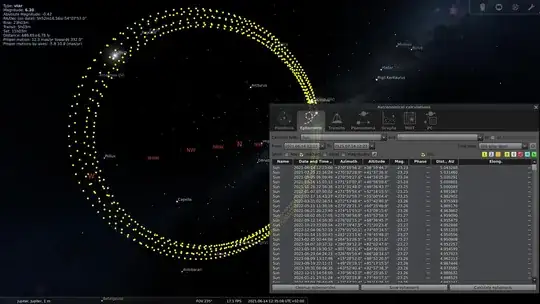

From Jupiter, the analemma seems to draw a bunch of rings. the analemma seen from Jupiter
Why does the analemma from Jupiter have this strange shape?

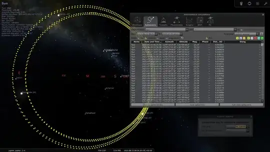

Per @User123's answer, I was using the Earth solar day rather than Jupiter's solar day to plot the position of the Sun. So I re-did the experiment with a time step of 99.258 hours (= 10 Jupiter days) over the course of 12 Earth years (a bit more than 1 Jupiter year). Here is the result.
Why is the Sun drawing a bunch of circles in the sky rather than a single circle ?

After some googling, I found this image of analemmas on different planets. Clearly, Jupiter's looks differently than yours. I reproduced yours example, and I got same results: Mars' analemma looks good, but Jupiter's is simply not similar to the real one.

I believe that the answer is related to lengths of solar days on planets. Imagine we set 1 solar day as one step for an analemma (= 24 hours). Thus, the Sun shows on its mean solar noon and shows correct analemma.
Let's now move to Mars. When you set 1 solar day on Mars, it correctly shows you the analemma. Mars' day is around 37 minutes longer than ours, thus the analemma should not be correct, but still it is. I believe that the developers of Stellarium also coded the solar day for Mars in Stellarium, so when you setup 1 solar day on Mars, it is actually same as 24 hours and 37 minutes. My assertion is that they didn't set the lengths of days on the other planets.

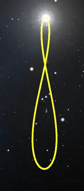

On the newest version of Stellarium, one can set custom step. Try to change step of 1 solar day to 1.001 solar days. The analemma changes a lot, from this ...
Correct Earth's Analemma
... to this:
Crazylemma

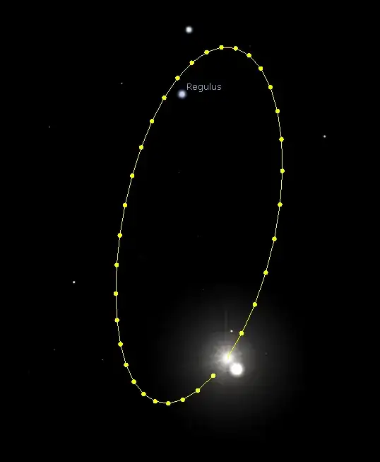

I think that Stellarium doesn't use same length of Jupiter's day as Wikipedia (it is made from gas), so such analemma (with even slight deviation) is incorrect. You have to use so called "Stellarium Jupiter's day". The multiple of such days is around 300.0201 solar days on Earth. I get a correct analemma with such step: Correct Analemma
Try to reproduce it:
  • Place: anywhere on Jupiter
  • From: 2021.06.16 12:00, To: 2033.03.09 12:00
  • ✓ line ✓ markers □ dates □ magnitude ✓ H.C.
  • Time step: custom interval: 300.020100 solar days (around 725 Stellarium Jupiter's days)
