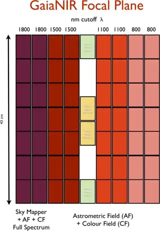

The image below shows the proposed focal plane of "GaiaNIR" with long-wavelength cutoffs ranging from 800 to 1600 nm. The short wavelength cutoff is 400 nm for all.
The paper outlines four technologies that could be considered for the imaging sensors, since many require sensitivity well outside of silicon's bandgap limit of roughly 1100 nm.
For completeness here are all four, but my question focuses on #4 (MKIDs).

Proposed focal plane array and filter bands used in the GaiaNIR CDF study source click for larger
Proposed focal plane array and filter bands used in the GaiaNIR CDF study (see page 203 in https://sci.esa.int/s/8a65kZA). The array consists of 60 NIR detectors, arranged in 7 across-scan rows and 9 along-scan strips (out of which 8 are for the astrometric/photometric field, divided into 4 photometric fields (i.e. 4 different cut-off wavelengths each starting from ∼ 400 nm). The new array is less than half the size of Gaia’s
