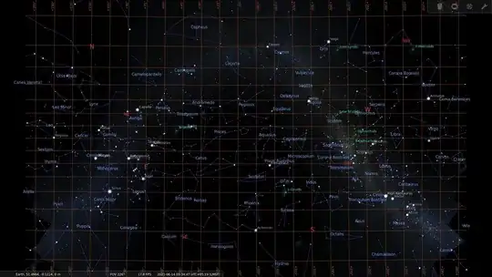

You can now use a star map to find the direction that the Earth will travel in. On January 1st the Earth will travel in a direction toward an ecliptic longitude of 190, but remain in the plane of the ecliptic. On the map below, the ecliptic is the line through the middle of the map and you can find where 190 is by looking at the numbers at the top and bottom.
Because in the absence of the sun, there would be nothing to cause the Earth to orbit, it would travel in a straight line towards that point.
