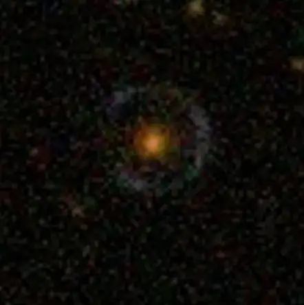

The cosmic horseshoe is beyond amateur instruments. It is a magnitude 20 object. In a large (2.5 m) professional telescope it looks like:
This image taken from the SDSS III data. It is small (10'', half the size of Mars at opposition) but that is not insurmountable for amateur equipment. But is it very dim. If an object like this was visible in moderate telescopes, it would have been found long ago. It is really only the sky surveys, and computerised searches of the survey data that allows for such objects to be found.
