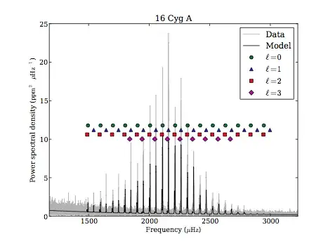

@ProfRob has already given a good answer to the question, but I wanted to add just a little more detail addressing the observational data side. As Rob already stated, the fundamental data often come (these days) from satellites like Kepler or TESS, which can measure a star's brightness with very high precision, over an uninterrupted period of many days. So these timeseries brightness measurements are the key observational data.
Because the star is pulsating slightly, its brightness changes slightly. By analyzing the brightness timeseries (e.g. with Fourier techniques), it is possible to find the frequencies at which the star is pulsating. It is this set of frequencies (their absolute values and their relative strength and spacing) that allows calculation of the sound speed. An example of this "power spectrum" (the relative strength of different pulsational frequencies) looks like this:
pulsation frequency spectrum
(linked from this Astrobites post)
