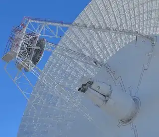

It's really hard to add a new multi hundred kilowatt transmitter to an existing very large dish like a 70 m DSN or FAST. You can read more about that in answer(s) to What is a Beam Waveguide dish and why does the Deep Space Network use them?. The big 70 m DSN dishes use the focus up between the primary and secondary; it is a real challenge to add more hardware there. The image below shows a DSN 70 m dish, for scale, the red lines in the dish itself are a safe walking path and going up each arm of the secondary reflector are stairways for people, not ants.

From this answer to Why is the reflector on this millimeter-wave antenna spinning?:
Below are photos of one of the 70 meter Deep Space Network telescopes for talking to deep space spacecraft. This one is in the Goldstone complex. From the relative sizes in the image, the secondary mirror is close to 8 meters in diameter. Considering the size and mass of the secondary (those are stairs for humans on each leg, and the red lines in the dish are "safe paths for walking") other, more advanced techniques to scan electronically have been developed, but the concept is the same.
ASA Deep Space Network 70 m dish antenna detail
above: Photo credit JPMajor, creative commons CC BY-NC-SA 2.0. click for larger.
NASA Deep Space Network 70 m dish antenna detail
above: From commons.wikimedia.org click for larger.
