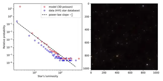

Building on the answers from @anders-sandberg and @ProfRob I think I get an answer for my own question. I am most certainly reinventing the wheel, but it has been fun. Please comment or edit if you know any pointer on a similar derivation.
As a (very) rough approximation, one may assume that in a given line of sight, there is locally a uniform, independent and identically distributed density of stars. This can be modeled for instance by a 3D Poisson distribution. A 3D Poisson distribution consists in drawing random positions in space independently for the 3 axis and independently for the different points.
As a consequence, there are stars in all directions, but they have different luminances due to their distance. It is easy to derive the probability distribution of the distance for such a model and by a change of variable, one can find that of luminance as :
$$ \text{Pr}(L) \propto \frac 1 {d^{\frac 5 2}} $$
This is what you get with a simple simulation by placing stars at random positions in the universe but also if you plot the distribution of the luminance for stars drawn from a catalog of more than 100k stars (left panel):
result
In addition, it is also a way to build a very simple model for generating images of the night sky (right panel).
The full details of my musings are available in this blog post.
PS: the other part of my question (can such a model be used to fit the density of stars in different areas of the sky?) will be for another time...
PS2: There is a relation with Olbers' paradox which I discuss in the post...
