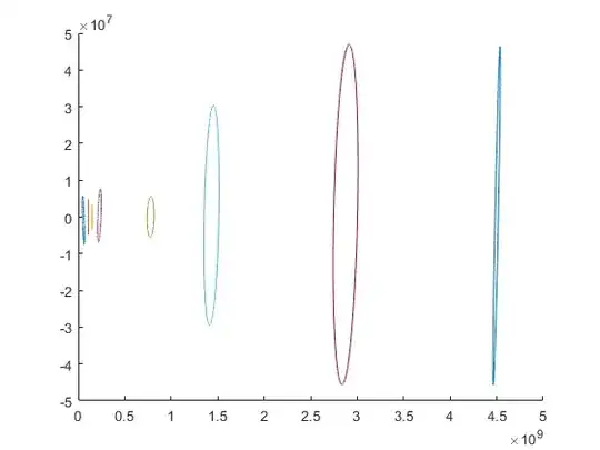

On a previous answer, I made a diagram of the distribution of the orbits of the planets along the Sun's equatorial plane. Here is a diagram of the distributions along the ecliptic plane.enter image description here
We can only see seven shapes since the Earth's orbital inclination with respect to the ecliptic is zero. We can see that Neptune's orbit dominates the width of a containing disk. The maximum y-value is about 140.06 million km, and the minimum y-value is about -137.61 million km. So the disk width $h$ is 277.67 million km, or about 1.86 AU.
I already had point sets for all the orbits, so I ran a search through all possible 3d rotations with a granularity of .1 degrees to find the thinnest disk possible. An azimuth rotation of 151.6 degrees and an elevation of 1.3 degrees yields another plane in which the maximum width is 92.5 million km or about 0.619 AU. You can see in the orientation along this plane, the maximum distances from Neptune and Uranus to the plane are equalized.
