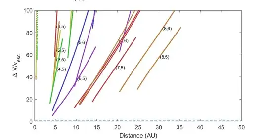

For a body to be bound to another body of mass $M$ it need to move slower relative to it than escape velocity $v_{esc}=\sqrt{2GM/r}$. If we assume planets move in circles we can then take their orbital velocities for all possible positions along the orbit, calculate the relative velocity, and compare it to the escape velocity.
The result is this diagram, where I have plotted the separation on the x-axis and how many times escape velocity the relative velocity is on the y-axis. The numbers denote which pair of planets I am comparing. The blue horizontal line is $\Delta v=v_{esc}$. Relative velocities compared to escape velocities for planet pairs
Looking just at the lowest relative velocities shows that the closest to being potentially bound is Saturn to Jupiter were the sun vanish just as they are moving in parallel, but even in this case Saturn has several times Jupiter escape velocity.
One could complicate it with inclinations and elliptic orbits, but it will not change the qualitative picture: the planets are not even close to being bound to each other in the absence of the sun.

    The formula you're using for escape velocity $v_{esc} &= \sqrt{2GM/r}$ is for the case where the mass of the escaping body can be ignored. For planets that's not valid, and the escape velocities will be higher due to the mass of the other planet that this equation ignores. – JanKanis Feb 23 '21 at 11:35
  • @JanKanis that was my hunch as well, especially seeing separate lines for (5,6) and (6,5). Not sure the adjustments are enough to make a difference to the final result, though. – jcaron Feb 23 '21 at 11:58
  • @JanKanis - Yes, you are right. I checked with running with the reduced mass, and it moved things a little bit (since it is smaller than either mass it reduces V_{esc} and makes it harder to get bound orbits), but does not change the overall conclusion much. Thanks for writing the refined answer! – Anders Sandberg Feb 23 '21 at 16:10
    @AndersSandberg I might suggest using the mutual escape velocity $v_e=\sqrt{\frac{2G(M+m)}{R}}$ derived here: https://physics.stackexchange.com/questions/121679/is-escape-velocity-the-same-for-all-objects/121834#121834. It will dispel this argument and cut the number of pairs you need to graph in half. It should increase rather than decrease $v_e$. By the way, I think your graphs are a genius way of presenting this problem! Love this answer! – Connor Garcia Feb 23 '21 at 16:43

I gave a try at refining Anders Sandberg's answer with the equations for a two body system.
Basically, a two body system is bound if the sum of the total kinetic energy and the (negative) gravitational potential energy is still negative. (To escape, kinetic energy needs to cancel out the potential energy.)
Gravitational potential energy:
$$U = -{GMm\over{R}}$$ where the gravitational constant $G = 6.67430×10^{−11}\ m^3kg^{–1}s^{–2}$, $M$ and $m$ are the masses of the two bodies, and $R$ is the distance between them.
The total kinetic energy is the sum of the kinetic energies ($E={1\over{2}}mv^2$) for each body relative to the common center of mass.
According to Anders' plot Jupiter and Saturn are the closest to being bound, so I made a calculation for that pair using data from these nasa pages, ignoring excentricity and inclination.
Jupiter:
$M = 1.898×10^{27}\ \text{kg}$
$\mathrm{semimajor\ axis} = 778.570×10^{9}\ \text{m}$
$v = 13060\ \text{m}⋅\text{s}^{-1}$
Saturn:
$M = 5.683×10^{26}\ \text{kg}$
$\mathrm{semimajor\ axis} = 1433.529×10^{9}\ \text{m}$
$v = 9680\ \text{m}⋅\text{s}^{-1}$
At closest approach, the distance $R = 654.96×10^{9}\ \text{m}$. The gravitational potential energy then becomes $-1.099×10^{32}$ joules.
The difference in speed $\Delta v = 3380\ \text{m}⋅\text{s}^{-1}$. Weighted by the relative masses that velocity is attributed to Jupiter for 23% and to Saturn for 77%. This gives Jupiter a kinetic energy of $5.76×10^{32}$ and Saturn $19.23×10^{32}$
So in conclusion, the kinetic energy is about 25 times too high for Jupiter and Saturn to be bound, so they will fly apart.
