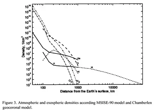

It is not too difficult to calculate the amount of gas that can escape the gravity field of the planet. Let's consider atomic hydrogen (mass m=1.6*10-24g} in case of the earth. The density at the height of about 400:km (above which the atmosphere can be considered collisionless) is about $n=10^5/cm^3$
upper atmosphere density profile
The temperature can be quite variable between about $600K$ and $2000K$ depending on daytime and solar activity. Let's take a medium value of $T=1200K$ here. The height of 400 km would then make the radius at that level $R=6778 km$ and thus the total area of the sphere $A=4\pi R^2$. The escape flux from one square centimeter of that sphere is (assuming a Maxwell velocity distribution and considering that only half of the atoms (going upwards) can escape)
