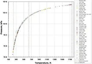

How do non-metallic liquid telescope mirrors remain as liquid in the vacuum of space?
The proposed mirror uses an ionic liquid rather than a real liquid metal (e.g. mercury or some other eutectic). Nobody balks as using mercury because it might evaporate, because we have some sense that at low temperatures (e.g. room temperature) those of us who are old enough might have played with a bit in school presumably in a glass dish or at home from a broken thermometer, and remember that it just sits there; it doesn't boil away and nobody was worried about breathing vapor from it.
That's because the vapor pressure of mercury at room temperature is only of order $3 \times 10^{-7}$ atmospheres and the evaporation rate is low. We would not do such things today, but we have at least seen images if liquid mercury in air and don't think of it as evaporating quickly, and have heard of spinning mercury telescopes and mercury based barometers with one end exposed to atmosphere.
Going even somewhat below room temperature the vapor pressure and evaporation rates of mercury plummets.
It turns out that ionic liquids even those based on organic molecules can have similarly low vapor pressures in the regime below room temperature and above their freezing points.
An ionic liquid (IL) is a salt in the liquid state. In some contexts, the term has been restricted to salts whose melting point is below some arbitrary temperature, such as 100 °C (212 °F). While ordinary liquids such as water and gasoline are predominantly made of electrically neutral molecules, ionic liquids are largely made of ions and short-lived ion pairs. These substances are variously called liquid electrolytes, ionic melts, ionic fluids, fused salts, liquid salts, or ionic glasses.
So because their constituents hold each other due to strong ionic forces, many of these liquids can have very low vapor pressures and evaporation rates at room temperature and even lower at reduced temperatures still above their freezing points. These temperatures are readily available in space environments; as long as sunlight is appropriately shielded, radiative cooling to space allows access to cryogenic environments.
Angel et al. 2008 says:
Borrowing from techniques used to coat solid mirrors on Earth, we conducted a number of experiments coating a variety of liquids by vaporizing silver on their surfaces. A recent article (Borra et al. 2007) summarizes our recent efforts. We successfully coated an ionic liquid with silver. Coating an ionic liquid was a major breakthrough because ionic liquids have negligible vapour pressures and thus do not evaporate in vacuum. We experimented with a commercially available ionic liquid that solidifies at 175 K and we are actively pursuing ionic liquids with lower freezing temperatures. There is a realistic expectation of success because ionic liquids are organic compounds and there are at least 106 simple ionic liquids, and 1018 ternary ionic liquid systems (Borra et al. 2007), giving a phenomenally wide choice for optimizing the properties of the liquid substrate.
Borra et al. 2007 can be found in Nature: Deposition of metal films on an ionic liquid as a basis for a lunar telescope and also accessed in researchgate
"Figure 1. Experimental vapor pressure data for mercury." NIST 6643 enter image description here
click images for larger size
left: "Figure 1. Experimental vapor pressure data for mercury." Source: NIST Internal Report The Vapor Pressure of Mercury NISTIR 6643 (also here) and right: Source Don't do this!
