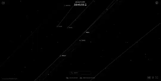

Mars, Earth, Moon, in space...
In general... January 31, 2014 - 10:30pm. This broad view looking downwards at the plane.
Solar system illustration
And again...
And from beneath the plane... showing us just how far ahead Mars was relative to Earth.

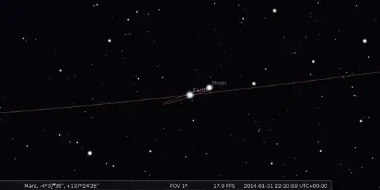

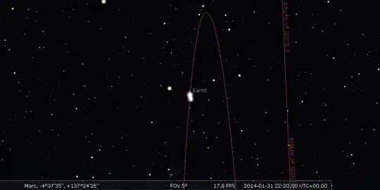

In other words, the Moon should appear about 0.11° west of Earth in the Martian sky, or to the right if Mars's north celestial pole is up:
Stellarium: Earth and Moon from Mars, equatorial orientation
But looking toward the western horizon (zenith up) from a tropical latitude, celestial north is to the right, so the Moon appears below Earth in the photo.
Stellarium: Earth and Moon from Mars, alt-az orientation
