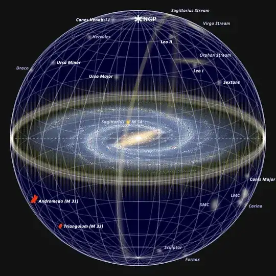

The Sun and most of the other stars are in the bulging disk of the Milky Way galaxy, but about 1% of the galaxy's stellar mass is in the galactic halo. The halo also includes 50 globular clusters and about 20 satellite galaxies according to Helmi 2008: The stellar halo of the Galaxy. Here is a nice graphic:
Note that the Sagittarius Stream of stars is extremely close to passing the galactic poles. If you were on a planet next to one of these stars as it passed a pole, you would probably have a glorious view of the Milky Way stellar disk.

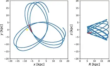

Bodies in the galactic halo don't necessarily follow the elliptical paths predicted by Kepler, so their orbits may not be consistently perpendicular to the galactic plane. Some stellar streams have extremely odd orbital paths like the Phlegethon stellar stream, referenced in this answer:

    Do we have a good sense of how big in the sky the Milky way would be from a hypothetical Earth-like planet in the Sagittarius Stream (at "typical" or furthest extent)? Andromeda sized? Moon sized? Filling-up-half-the-sky sized? – R.M. Jan 15 '21 at 17:00
  • @R.M. as seen from close to the galactic poles, the Milky Way should be 90° wide, shouldn't it? 1 radius away, 2 radii wide. ◺ – Eric Duminil Jan 15 '21 at 17:14
    @ksousa The galactic halo has a lot of substructure and star clumps that astronomers refer to as "overdensities". So while the average distance between stars in the halo is large, a star picked at random is likely to be in a star-dense region of space. This would be another great questions for Astronomy Stack Exchange. – Connor Garcia Jan 15 '21 at 17:47
    @R.M. The above graphic is somewhat misleading about the distribution of stars in the Halo as it depicts them in a thin "shell" around the galactic disk. The orbits among stars in the Galactic Halo vary enormously. Some pass quite near the center of the galaxy and then zoom way out again, similar to a comet in our Solar System. Since their position in the shell varies, we would expect the apparent size of the Milky Way from their vantage point to vary accordingly. These stars are often called Population II stars. – Connor Garcia Jan 15 '21 at 17:57
