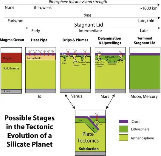

A study by Stern et al. (2017) used volcanisms, faults and impacts to define a "Tectonic Activity Index" (TAI) for 26 planetary bodies, ranging from 0 to 3. They found that Mars has a TAI of 2, less than the Earth and Venus (3), but still inferred to be "tectonically and convectively active" (bodies with TAI < 2 are inferred to be tectonically dead). They think that Mars actually represents the transition between active and dead bodies:
The present tectonic style of Mars represents an almost completely stabilized stagnant lid [SL]. Here, a single upwelling mantle plume, pouring lava out at the same sites for hundreds of millions of years, produced the immense Tharsis rise and volcanoes (Zuber, 2001). When these last few mantle plumes are extinguished, tectonic style transitions to the final SL stage – planetoid death. This stage is typified by Mercury and Earth's moon, bodies with ultra-thick, ultra-stable lithospheres
enter image description here Possible evolution of magmatotectonic styles for a large silicate body, like the Earth. Plate tectonics requires certain conditions of lithospheric density and strength to evolve and is likely to be presaged and followed by stagnant lid tectonics. After Stern et al. (2017) (CC BY-NC-ND 4.0)
