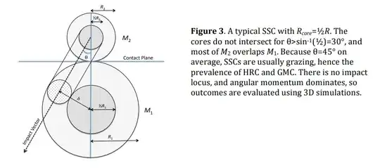

Almost certainly not.
All available information seems to indicate that the Earth will probably not reverse it's spin direction before it ends. However, we don't have absolute certainty of this.
Inner-planetary collisions
There are numerical simulations indicating the "Existence of collisional trajectories of Mercury, Mars, and Venus with Earth" within 5 Gyr time-scales, published in Nature by Laskar and Gastineau 2009. These are based on the possibility of potential resonance orbits of the inner planets with Jupiter. Laskar was influential in showing that the Solar System is a mathematically chaotic system on large time scales. While the probability of inter-inner-planetary collisions was extremely low according to their simulations, $unlikely \ne impossible$. For certain grazing impacts, "angular momentum dominates" according to Elkins-Tanton and Weiss 2016 as shown in one of the excellent figures from their paper:
A sufficiently energetic inter-planetary collision could certainly change Earth's spin direction and either merge, graze, or potentially strip the mantle.
Exoplanetary collisions
Also, I don't think we can rule out the possibility of a near miss of our Solar System with another stellar system within the Milky Way. We know that there are some stars in retrograde galactic orbits that cross the Sun's prograde orbit around the Milky Way. If our Solar System was to pass through the stellar system of a retrograde star, an Earth collision with an exoplanet would be possible.
