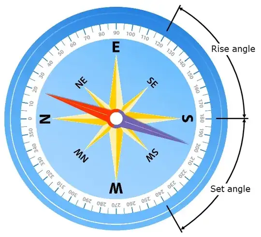

If you visualize a compass, the angle that a star rises and sets is the same angle measured from due south (for those in the northern hemisphere). This figure shows a star rising 60 degrees from due south (at an azimuth of 120 degrees). The same star sets 60 degrees from due south (at an azimuth of 240 degrees). compass showing rise/set angle
The rise angle and set angle can be calculated from $$cos(angle) = -\frac{sin(dec)}{cos(lat)}$$ where $dec$ is the declination of the star and $lat$ is the observer's latitude.

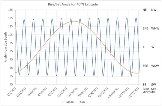

For the year 2021, you can see how the rise/set angle and azimuth of the Moon changes from "north of east/west" to "south of east/west" during one month (approximately). Of course, the Sun requires an entire year to go through the same cycle. rise/set angle for 1 year

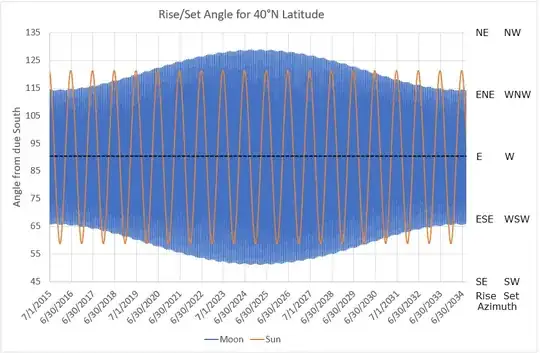

The azimuth changes because the declination changes, and the declination changes because the Earth's axis is tilted 23.5 degrees from perpendicular to the orbital plane. The Moon's orbit is inclined another 5 to 6 degrees from that. As Uhoh has mentioned, the inclination of the Moon's orbit sometimes adds to the declination and sometimes subtracts from it. This longer cycle takes 18.6 years to complete. The rise/set angle for a full cycle looks as follows: rise/set angle for 19 years
