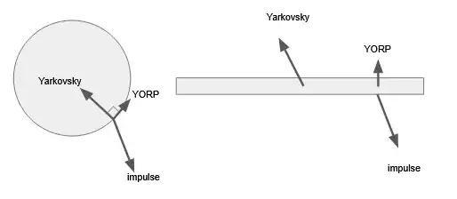

The forces causing the YORP and Yarkovsky effects are not tangential in general. For a recoil for some impulse on a sphere, the rotational and linear forces imparted are tangential. However, for an irregular shape like a rod, we wouldn't expect the two forces to be tangential. Here is a little drawing (extremely exaggerated for effect):
In the above drawing, the Yarkovsky vector represents purely translational momentum change and the YORP vector represents purely rotational momentum change. The sum of the vectors that represent forces that cause the YORP and Yarkovsky effects should sum to the mass recoil vector (which is the negative of the impulse):
They YORP and Yarkovsky forces don't necessarily need to be at right angles. In three dimensions, sorting out the forces can get extremely complicated. It can be quite complicated for a rod even if the reaction mass vector is at the tip. It's hard for me to imagine the recoil from a "crescent moon" shaped asteroid that has a center of mass exterior to the asteroid body.

    Isn't the green "Torque" arrow drawn in the wrong direction? And why does it have such a strange elliptical shape? – uhoh Dec 29 '20 at 22:41
    @uhoh Yes the green "Torque" arrow is drawn in the wrong direction and it shouldn't be curved. I apologize. I will get this corrected ASAP. – Connor Garcia Dec 30 '20 at 00:24
    I think for the purposes of this answer you can just add a parenthetical comment under the figure and leave it there. It's quite nice otherwise. As far as the original source of the image, that's up to you! – uhoh Dec 30 '20 at 04:58
    @uhoh Thanks. I am reworking the whole answer to also better address your original question if the force that causes the YORP effect is a tangential component of the force that causes the Yarkovsky effect. I expect to finish "soon." – Connor Garcia Dec 30 '20 at 05:03
