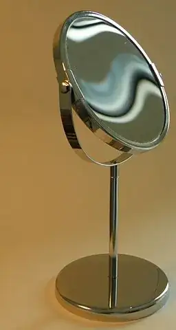

It is true that concave mirrors are "magnifying mirrors" and if we stay closer to the mirror than twice its focal point (see below) we can see a magnified image. I don't believe that it provides better optical resolution than a normal mirror, but since the construction of our eyes is fixed (we can't change the optical system nor "pixel density") we use the mirror to "blow up" the image in the same way that a photographic enlarger blows up the image on a negative without improving the resolution of the image.
https://commons.wikimedia.org/wiki/File:Magnifying_cosmetic_mirror.jpg source
