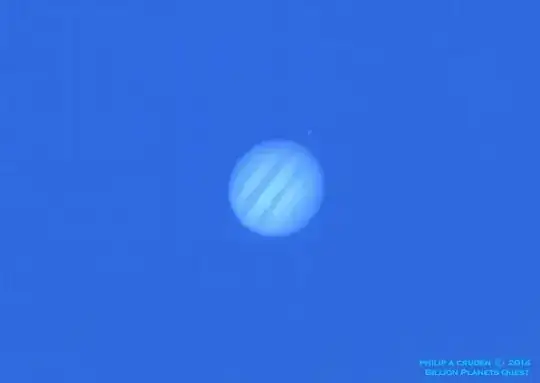

Jupiter can be seen during the day.
This image is by Philip Crude. Philip is an experienced astro-photographer. On his webpage http://www.billionplanetsquest.com/p/planets.html he gives details of the equipment and settings used:
This image was captured through my [i.e., Philip Crude's] Celestron CGEM-800 using a ZWO ASI120MC camera at prime focus. Resolution 640 x 480, 35fps best of 900, Brightness @ 1, Gamma @ 48, Gain @ 11. The image was acquistioned with SharpCap and processed with RegiStax and CS6.
Philip also tweeted the image here.
The main difficulty is pointing the telescope in the right direction, as you won't be able to align it against the background of stars, so you need to predict the position and point the telescope accordingly.

2Suggested edit : "The image was acquistioned with SharpCap and processed with RegiStax and CS6" rather than your last two lines - it's a direct quote from the second site you linked to about that image. – StephenG - Help Ukraine Dec 13 '20 at 18:21
7That edit with an out of context quote from Philips website made it look as if I was claiming to have taken the picture, which I wasn't. So i've deleted all the metainformation about how the image was captured It wasn't really relevant, I just hoped to indicate to the OP the sort of equipment that was used. If you want to see then follow the links. – James K Dec 14 '20 at 01:08
I edited Philips technical information back in because I think it is of particular interest in the context of this question, and we are encouraged to copy relevant parts of pages we link to. I edited the answer to make it clearer that it wasn't your photo, James. – Peter - Reinstate Monica Dec 15 '20 at 10:08
2Also, I'm compelled to add that I'm in awe of that picture. Stunning. – Peter - Reinstate Monica Dec 15 '20 at 10:09
4Notably caught Io in that shot as well. So if your next question was "Is it possible to observe another planet's moons during the day?", well... – Darrel Hoffman Dec 15 '20 at 19:11

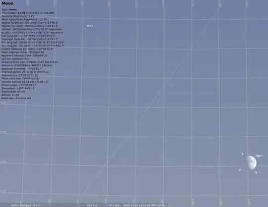

Moon as reference point
With a bit of patience, you can wait until the Moon is:
- not too close to the Sun
- close to the planet you would like to watch
If the angular separation between the Moon and the planet is less than ~5°, you can use Stellarium to know in which direction you should move your telescope. You can use the terminator as a reference line, and the Moon diameter (~0.5°) to know how far the planet should be. If the planet is further away, it might be too hard to use the Moon as reference.
First quarter moon () will be helpful if the planets are in the sky before sunset, last quarter moon () will be helpful if the planets are in the sky after sunrise.
You might have to try different eyepieces :
- if the magnification is too high, you might miss the planet
- if the magnification is too low, the sky will be really bright and the planet might not be visible
- the planet is probably not bright enough in the finder, compared to the background sky
With this method, I've seen Venus, Mars, Jupiter, Saturn while the sun was still in the sky, with a simple Dobsonian. No need for GOTO or equatorial mount.
I've also watched Mercury during the day, by using Venus as a reference point.
You could try next week, 23rd of December, at around 15:00. The sun will be SW, the moon and Mars will be around SSE (as seen from the northern hemisphere). Mars will be a bit further away than 5° from the Moon, but it might still be doable.
Stellarium tips
Stellarium can help you find the right moment:
- Click on the Moon
- Track the Moon (Space)
- Hide the ground (G)
- Hide the atmosphere (A
- Equatorial mount (Ctrl + M)
- Equatorial grid (E)
- Press L repeatedly to advance in time
- Press K to stop when the Moon is close to a planet, preferably during a quarter moon.
- Show the ground and atmosphere again, to see when the Moon and planets are high in the sky.
