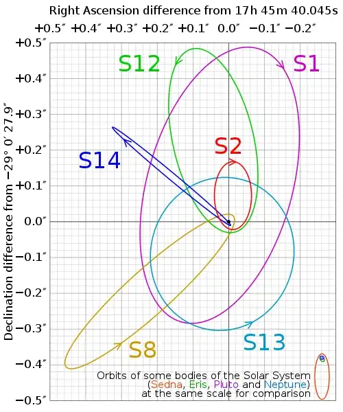

The stars near Sgr A* have a wide variety of orbital eccentricities. This is shown clearly in the picture below (credit: Cmglee, Wikimedia commons).

2What's a non-Keplerian orbit? I thought every orbit is "closed", what would such non-Keplerian orbits look like? Also, do you know the scale for your above diagram, how long e.g. is a light-year or parsec there? – John Oct 31 '20 at 11:32
Or does "at the same scale" mean the orbit of Sedna is as big as it would fit into the diagram since it is around the black hole in the galactic center so it's hard to believe. – John Oct 31 '20 at 11:35
3@John the diagram has a scale. The orbit of Pluto is a little bit less than one small graph paper square across, so I guess one small graph paper square is about 120 au. Non-Keplerian means it isn't an ellipse. Not a closed orbit means it doesn't return to the same point. – ProfRob Oct 31 '20 at 13:34
