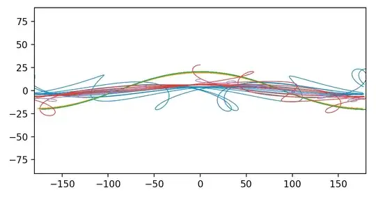

Below is a five-year simulation of fictional circular orbits of Venus, Earth, Mars and Jupiter-like objects and two Earth moons with a period of 0.5 years; one prograde and one retrograde.
Earth's orbit is the ecliptic, all planets have inclinations of 10 degrees, moons are slightly split at 19.5 and 20.5 for visibility.
We see the familiar switch back and forth between apparent prograde and apparent retrograde motion against the stars for the planets, but the moon just moves smoothly in its inclined orbit.
Basically a 1/2-year moon would behave just like the 1/13-year moon we have now except do it more slowly and in apparent synchrony with the Sun.
  • For the prograde moon we'd have 1 full moons and 1 new moons per year.
  • For the retrograde moon we'd have 3 full moons and 3 new moons per year.
There would be nothing otherwise remarkable or interesting except for the annual or tri-annual nature of its phasing with respect to the seasons.
random simulation
Python script: https://pastebin.com/ZLTWr9g2
