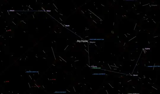

Here for example, is the Big Dipper asterism, but I've turned on Proper Motion vectors ... the vectors (shown in a light brown color) indicates the direction of that star's motion (relative to us) and longer vectors indicate great proper motion.
Big Dipper Asterism Proper Motion
Notice that many of the stars of the Big Dipper are all moving in the same general direction at about the same speed ... including Alcor/Mizar, Alioth, Megrez, Phecda, and Merak. In this diagram, those stars are all moving up and to the left (relative to this frame).
But more importantly... notice that Alkaid and Dubhe are going in roughly the opposite direction. These stars are moving down and to the right. This means that over thousands of years, this asterism will become distorted and will eventually not resemble the "Dipper" shape anymore.
Incidentally, the stars in the dipper that are going in the same direction are all part of an Open Cluster called the Ursa Major Moving Group. It isn't as obvious that it's an open cluster because it is relatively close (not all stars in Ursa Major are members of the cluster.)

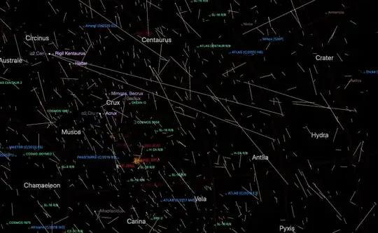

Here, for example, is the proper motion of Rigel Kentaurus (aka Alpha Centauri).
Rigel Kentaurus Proper Motion
In this frame (current time) the star is in the upper-left section of this chart. It is in Centaurus (hence its name) but near Circinus. But notice it has a VERY long proper motion vector which is headed toward the right side of this chart in the direction of Hydra.
Its proper motion vector is much longer than the other stars ... but Rigel Kentaurus is just a little over 4 light years away (one of our closest neighbors) -- so its relative motion is more noticeable.
While Rigel Kentaurus makes the top-20 list for stars with the highest proper motion, it's not the winner ... that spot goes to Barnard's Star (in Ophiucus). But Barnard's Star isn't very bright... at magnitude 9.5 it isn't noticeable to ordinary human vision and requires a telescope to see it. But it is moving just a little under 3x faster than Alpha Centauri A & B.

  • What's the scale of the proper motion vectors in the charts? how much time do the arrows represent? For example, at what time will Rigil Kentaurus reach Hydra (assuming of course that the motion vector remains constant)? Is this more in the range or thousands of millions of years? – Stephan Matthiesen Jun 15 '21 at 23:34
  • Rigil Kentaurus has a proper motion of about 4 arcsec per year, so if I calculate this right it will need roughly 1000 years for one degree. That's about a fifth of the distance between Alpha and Beta Centauri, so Centaurus visually will change somewhat but it would be hard to notice, I guess. – Stephan Matthiesen Jun 15 '21 at 23:57
