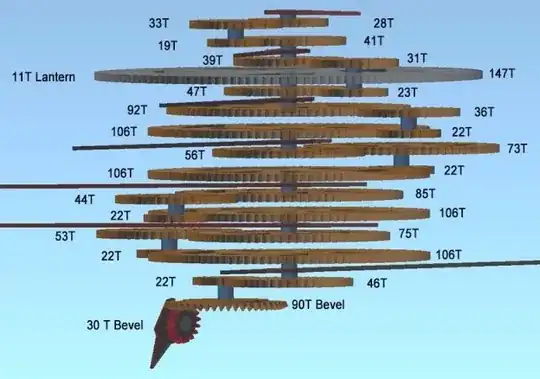

This line of thought is what every Orrery builder goes through when they choose how many teeth to put on their gears.
Of course if you want to use off-the shelf gears with standard tooth numbers instead of DIY, or you want to keep max to min sizes within a restricted range (it's hard to do 240:1 all at once) then you have to get more clever!
Results of Zeamon's Orrery gear ratios:
Object       Actual      Orrery      Orrery
              days        days        years
Mercury      87.969      88.418      0.242071
Venus       224.701     224.870      0.61565
Earth       365.256     365.256      1
Moon         27.322      27.3322     0.07483
Mars        686.980     688.6454     1.885377
Jupiter    4333.036    4314.8143    11.81312
Saturn    10755.704   10807.1021    29.58775
Century   36525.636   36621.5429   100.2627
File:Orrery_small.jpg File:Frederiksborg_slot_-_Museum_20090818_28.JPG
Source and Source

  • Many thanks for your long and detailed reply. In your orrery, what is the time interval in years between any 2 repetitions of the same 5 planetary positions, ignoring the moon? I realize that the second time around the 5 planetary positions may be a little off compared to where they were initially, – doctorsundar Oct 05 '20 at 20:40
  • @doctorsundar That's an interesting question! I've included links and discussion to orrerys just to give context to why approximations that will eventually, inevitably repeat are still of interest to some people, even thought they don't reflect reality. I wanted to add some balance to the other slightly dismissive answer. It's not "my" orrery :-) although I wish it were! I don't know the answer to that question right now. – uhoh Oct 06 '20 at 01:51
  • @doctorsundar These are based on meshing gears, each with an integer numbers of teeth, and connected by rigid shafts. Object's cycles may be "a little off" from each other one orbit to the next, but after running long enough this system must come back to its previous position because it will always have a LCM as you mention in your question. But it could be very large if enough shafts are used. Imagine a 100:101 pair with a shaft going to a second 101:102 pair, and in parallel a 103:104 pair with a shaft going to a second 104:105 pair. – uhoh Oct 06 '20 at 01:56
  • @doctorsundar I don't know how to do the math exactly, but those hypothetical planets must require thousands or perhaps tens of thousands of slowly de-phasing orbits before they return to their original configuration with respect to each other, but eventually they must. However it may take millions of orbits before they return to the same configuration together with a third orrery object. That might be the basis of a new and interesting question! If carefully written, it might be better asked (and better received) in Math SE than here. – uhoh Oct 06 '20 at 01:59
  • @doctorsundar if you do ask there, definitely include a link back to your question here and mention what information isn't yet available in answers there. They are a kind and helpful community, and as long as you describe a specific mathematical problem you often get several good answers, even if eventually closed :-) – uhoh Oct 06 '20 at 02:02
