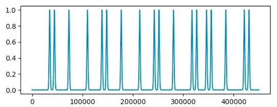

@JamesK's answer to When will the next transit of Earth be visible from Mars? Was the last one really on May 11, 1984? lists dates of 18 transits which I've converted to days since 1500-Jan-01 as
[35011, 44319, 73176, 109885, 138742, 148050, 176908, 213616, 242474, 251782, 280639, 317347, 326656, 346205, 355514, 384371, 421078, 430388]

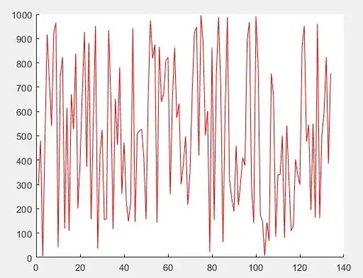

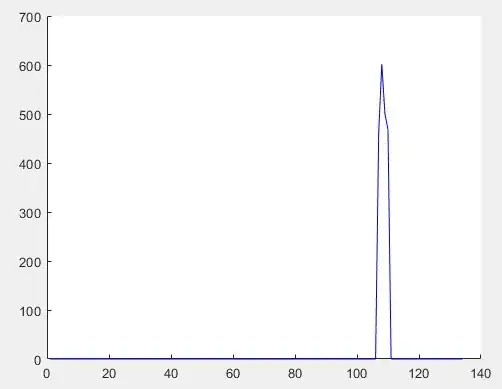

Let’s simulate some pulses based on the first pulsar found, the PSR B1919+21. This pulsar has a period of about 1.34 seconds, and a PW of 0.04 seconds. Let’s suppose our detector is not too great and we sample at 0.01 seconds from the absolute value of a uniform distribution with a mean of 400 photons, standard deviation of 200 photons, so a single simulated noiseless pulse in the time domain looks like this:
The x-axis is samples at 0.01 seconds. The y-axis is photon count. Then let’s produce some noise using the absolute value of a mean of 0 with 1000 standard deviation.
Then let's add the noise and the pulse together. This is what our simulated detector sees for a faint pulsar:

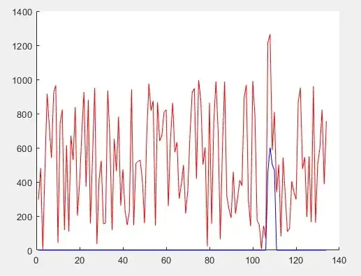

The pulse barely clears the noise floor, and we wouldn't be able to determine that it's 0.04 seconds wide just from this data. Here is the pulse and detection plotted together:

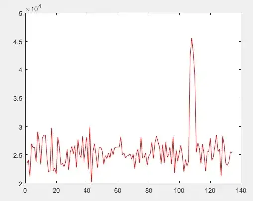

We can capture 50 pulses by observing the signal for over a little more than a minute duration:
If we divide all the observational data into 50 separate windows (with a good guess for period) we can add all the windows together (element wise). In the new window, the pulse is clear, since the noise tends to cancel out, and the signal compounds.

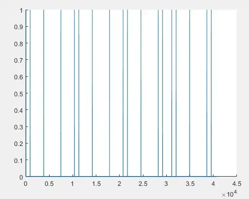

However, I like pounding in nails with a screw driver and we can pickle that! Let's cut out the leading zeros and divide the days by 10 and round so we don't get 'off by one' alignments when we fold. Then let's create a square wave for each transit:
We can chop it into 4 equally sized windows:
