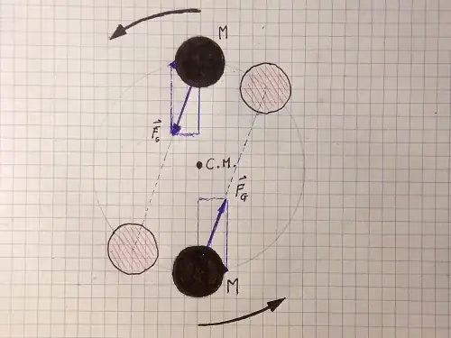

Imagine two massive objects, with the same mass (M) circling around their center of mass (C.M.). Let's assume that the distance between them is 1 light hour. Don´t the two bodies get accelerated and move away from each other because they feel the gravity of each other as it was 1 hour ago, because of which a force tangent to the direction of the speed develops?

4Gravity isn't a force in GR. Gravity is a force in Newtonian mechanics and Newtonian gravity makes incorrect detailed predictions about orbits. I'm unclear what kind of answer you are expecting. In GR the bodies do not move away from each other (ignoring any tidal effects), they move closer together because the system radiates gravitational waves. – ProfRob Sep 13 '20 at 11:38
@RobJeffries So the answer is no? Isn't the so-called force transmitted by gravitons in string theory, in a flat spacetime? Which is the same mechanism as the transmission of other forces? So, actually, we can speak of a force? Mass-energy (the energy-momentum tensor) being the charge? – Deschele Schilder Sep 13 '20 at 18:42
2I am not sure the position where the other mass was 1 hour ago is even well-defined. It depends on the speed of the frame of reference. – Florian F Sep 13 '20 at 20:35

No. Newtonian mechanics does quite well assuming instantaneous gravity. You can get relativistically correct orbits either by doing a complete GR calculation, or using a simple approximation as already eluded alluded to in @antispinward's answer.
This excellent answer to Besides retarded gravitation, anything else to worry about when calculating MU69's orbit from scratch? in Space Exploration SE explains that we get the wrong answer if purely Newtonian mechanics is used except for slowing down the speed of gravity, but that's because one is neither treating gravity correctly nor using Newtonian mechanics correctly.
Many answers to How to calculate the planets and moons beyond Newtons's gravitational force? include a way to treat this problem using a well-accepted approximate treatment of general relativity.

@TomRussell no, information about gravity moves at the speed of light only. It's just that if you use purely Newtonian physics and just add a delay the simplest way possible you don't get the right answer because you're mixing apples and oranges while trying to make lemonade. If you use a purely general relativistic treatment, you get back to the right answer. – uhoh Sep 14 '20 at 02:21
@TomRussell See Have more recent LIGO/VIRGO gravitational wave measurements narrowed down the speed of gravity further? for an experimental confirmation of the speed of gravity, and this answer for what happens when you mix apples and oranges trying to make lemonade :-) – uhoh Sep 14 '20 at 02:25

Patching a finite speed of gravity on top of Newtonian physics, as you have done in your example, doesn't work: it gives predictions that are inconsistent with observation, among which is that a two-body system would become rapidly unstable through the mechanism you depicted.
You need to use general relativity to analyse this situation, and it turns out that when you do that, the physics (at least in the regime where gravity is weak) almost exactly compensates for the effect of a finite speed of gravity.
As noted in this article by Steve Carlip, a similar effect occurs in electromagnetism, where the force is directed towards a charge despite the force being propagated at the speed of light.
The compensation is not exact, which can be observed in certain systems, for example the anomalous precession of Mercury's orbit Isn't the spacetime curvature "around" the Sun static? Which means that the speed of gravity is not the cause of Mercury's orbit? Isn't the cause simply the distorted spacetime? – Deschele Schilder Sep 12 '20 at 22:14
2@DescheleSchilder - Distorted spacetime is gravity, and the Sun is also affected by Mercury's gravity. In any case, the point is that general relativity does not yield the exact results of Newtonian physics, and if you want to incorporate the finite speed of gravity, you have to use general relativity not Newton+slow gravity. And to be honest, general relativity makes my head hurt in the case of a single mass, a two-body system with anything other than a test particle is a nightmare. – Sep 12 '20 at 22:23
But how does the speed of gravity make the orbit of Mercury precess? – Deschele Schilder Sep 12 '20 at 22:51
@DescheleSchilder - it's a consequence of general relativity, which you need to use in order to incorporate a finite speed of gravity because Newton+slow gravity does not match observations. Nevertheless my reference is clearly causing confusion and leading to this going off-topic from the original question, so I've removed it from my answer. – Sep 12 '20 at 22:53
