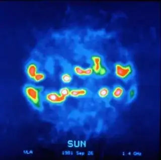

This page shows an image of the Sun at 4 GHz and it's relatively dark but lined with bright "spots" in two bands on either side of the equator.
But what does the Sun "look like" below 100 MHz? Is it just a fuzzy, unresolved blob that fades to zero at several solar radii, or can one resolve the Sun's edge.

The radio Sun: radio image of the Sun recorded by VLA. The brightest regions are part of corona nearby but beyond sunspots. Courtesy (NRAO/AUI) 4 GHz. (click for larger)

Below about 300 MHz you can only see the sun's corona as the frequency is too low to penetrate the coronal plasma from further below. In Wikipedia's Solar radio emission you can see images of the sun from 17 GHz down to 80 Mhz.
By Patrick McCauley Mccauley.pi - Own work, CC BY-SA 4.0, https://commons.wikimedia.org/w/index.php?curid=99231226
Photos and a detailed theoretical discussion of observations between 150-450 MHz are given in C. Mercier and G. Chambe (2012) Morphology of the quiet Sun between 150 and 450 MHz as observed with the Nançay radioheliograph
