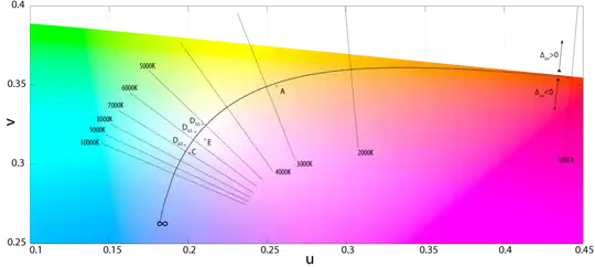

The apparent colour of a blackbody radiator in a CIE colour diagram is given by the Planckian locus. A pure blackbody spectrum for a given temperature, run through the standardized response of the human eye, will correspond to a point along the Planckian locus.
Of course, neither stars nor metal are perfect blackbody radiators so the colour may be a bit different when using a real spectrum, but I think it should give you an answer that's pretty close.
The following diagram (from the wikipedia page on Planckian locus) shows the Planckian locus as the curve going from 1000 K to infinity. As you can see, at around 5800 K, the temperature of our sun, it's pretty close to being white. At 2500 K, it looks to me like it would be an orange-yellow colour, with 3500 K giving a bright yellow, almost white colour.
The $D_{xx}$ points represent various daylight standards. As you can see, they're decently close to the Planckian locus, though I don't know whether a dwarf star would differ more or less from the Planckian locus than our sun.
The straight tick marks along the curve aren't really relevant to your question, but are for calculating the correlated colour temperature. Essentially, if you have some light source like an LED, you can find it's (u, v) coordinate and whichever line it lies along is the approximate colour temperature of that light source that you put on the box for selling it in a store.
Planckian locus CIE diagram.
