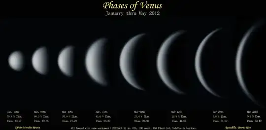

Since Mercury and Venus are always inside Earth's orbit and move with different rates around the Sun as Earth does, the Earth (the observer) is able to locate itself at any angle with respect to the light source that shines on the observed planet. This means that you can see any phase of Mercury or Venus (except from a perfect 100% illuminated phase due to the body of the Sun blocking the view). Here you have an example for Venus:

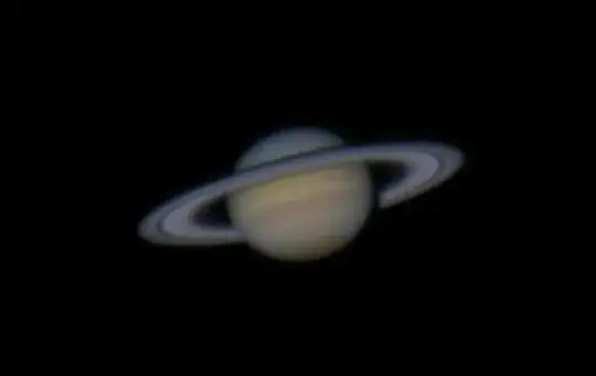

Before that we had never seen the night side covering more than a percent of the disk. Even the shadow of Saturn cast over the rings is nearly impossible to spot from the Earth. Look at this amateur photograph that shows precisely a bit of that shadow over the rings behind Saturn (bottom-right part):
That shadow is almost non-existent from Earth's point of view, and it's all because Earth's orbit is inside Saturn's and Saturn is far away from the Earth. The Earth is always so close to the line connecting the light source (the Sun) and the illuminated object (Saturn), that you shouldn't expect any more phases than "full" from here. Simple geometry.

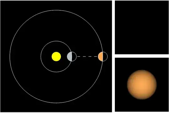

I made a little animation to demonstrate what others have already said. Here the outer planet is at 3 AU (Saturn is around 9 AU, much further). The light side of each planet always faces the sun. Since the earth is so close to the sun relative to Saturn, we can pretty much only see its light side. On the other hand, if you were looking at Earth from Saturn, you would see phases: when Earth is between Saturn and the sun, you see the dark side. On the right-hand side you can see the what each planet would approximately look like from the other.
