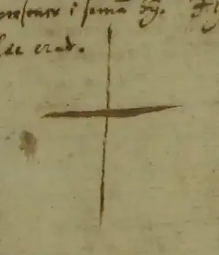

It is described as an elongated cross with the long arm being about 6 times as long as the short arm. I think it means to say that the long arm was vertical, but I'm not sure about that. The cross was shining clearly on the sky, a burning light in the north-east for about an hour. It was almost a clear sky and where the cross was there were no clouds at all.
The account is accompanied by this illustration. It doesn't have the same proportions as I understand the text to say. Maybe the image is better than the text. enter image description here

    A question on translation - given the appearance of the sketch, is it possible that what you translate as "long" is actually "wide"? That is, that the wide part was 6 times as wide as the narrow part? This may be unlikely, but I don't know what the words are in Swedish, and that would be more consistent with the drawing. – Eric Jensen Jul 30 '20 at 23:54
    This was almost certainly more "Earth Science" than "Astronomy". – Mark Jul 31 '20 at 02:32
    @ELNJ I don't think that's possible. It talks about how "långt" the parts are, which is length. Maybe I should have said that it never says "6 times" though, but that was my derivation. What it actually says is that the trunk was like "3 fathoms" and the other part "1½ ell" where a Swedish fathom (famn) was 3 ell (aln). – pst Jul 31 '20 at 08:11
