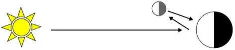

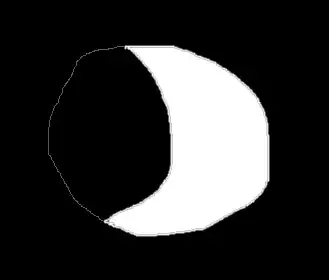

Some days ago, about 1 ~ 1.5 hours after the sunset I could see a very bright half moon, and the interesting part is, I think I could see the edge of the dark half of the moon, i.e. a whole circle, but with very little contrast to the surrounding black space. It was very weak.
I'll use my impressive graphic design skills to try to explain it better:
The line I'm talking about is that grey one on the left, closing the moon.
My hypotheses are:
  • My brain made it up, as if it was trying to "close the circle"
  • The earth was lighting the moon up, as in: light from the sun was hitting the earth and being re-emitted to the moon (as a very bright moon can actually provide you enough light to see in the dark).
Thanks!

    Have a look at https://en.wikipedia.org/wiki/Planetshine It is always okay to post an answer to your own question if you like :-) – uhoh Jul 30 '20 at 09:00
    @uhoh thank you very much! sometimes it's just a matter of finding the right term. – bgusach Jul 30 '20 at 09:43

As uhoh has written in the comments, this phenomenon is known as "planetshine", and in this case more specifically "earthshine". The sunlight hits the earth and is reflected to the moon, illuminating what cannot be directly reached by the sunlight.
https://en.wikipedia.org/wiki/Earthlight_(astronomy)

    of course there still is always the possibility that your "brain made it up, as if it was trying to 'close the circle'" but I think the chances are low ;-) – uhoh Jul 30 '20 at 12:21

    An additional point about your brain "making it up" - the dark side of the moon would have blocked out any stars behind it, making an area that could be distinguished from the rest of the stars. – IronEagle Jul 31 '20 at 07:58
    How come then we only see the edge slightly lit and not the whole dark side? The pictures posted in the comments show all, but in my experience I see only the edge of the dark side lit – Hakaishin Jul 31 '20 at 08:26
  • @Hakaishin Previously: https://astronomy.stackexchange.com/questions/1622/why-is-the-outline-of-a-crescent-moon-brighter (This is about the bright part, but I think the answers apply equally to the dark part.) – user3067860 Jul 31 '20 at 18:16
