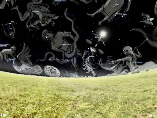

Star constellations are not visible during the day, but they are at night. The sun entering a constellation means that it rises in a constellation, i.e. if you look at the night sky just before dawn at the place where the Sun will rise, you will see that constellation. Also cultures differ in what they consider the start of a new day. In Judaism, for instance, a new day begins at sundown. I'm not sure how the Babylonians reckoned the start of a new day, but it looks like they considered the constellation that dominates the eastern night sky before dawn to be leading for the whole day.

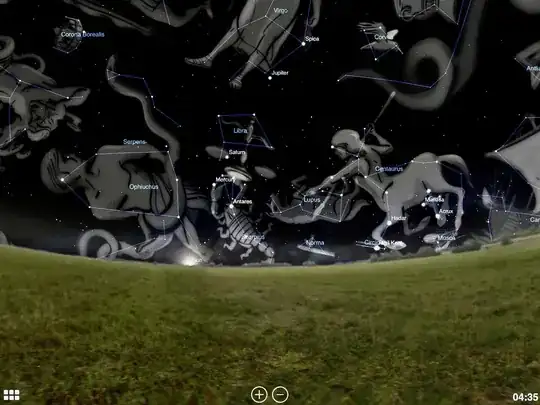

So, if you go to Babylon in November (it's 80 miles from Baghdad in Irak), will you see Scorpio precede the Sun at dawn? You would if the Earth spun perfectly straight, but instead the tops of the axis describe a little circle: this is called precession. So these days, in November, the sun is preceded by Virgo.
Compare these two screenshots from the app Stellarium, for the city of Baghdad in Iraq. The first one is from November 7, 1020 BC, the second one november 7, 2020 (yes, Stellarium allows time-travel).
Stellarium: sunrise at Baghdad November 7, -1020
Stellarium: after sunrise, Baghdad November 7, 2020
