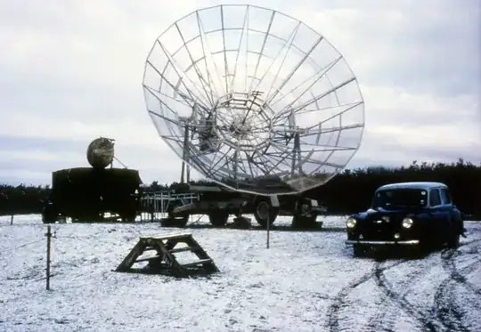

The 25ft Transportable Radio Telescope used with Jodrell Bank The 25ft Transportable Radio Telescope

  • @planetmaker You can't co-align an optical telescope with a 90-foot radio dish with anywhere near the needed level of precision; with a big dish there isn't any obvious large mechanical part pointing in precisely the center of the dish to align with. Even piggybacking two optical telescopes together requires significant tweaking and calibration to get them co-aligned at the arcsecond level. If you look at the picture above, you can see that it would be hard to attach a separate telescope and ensure that it is pointing in precisely the same direction. – Eric Jensen Jun 28 '20 at 18:08
