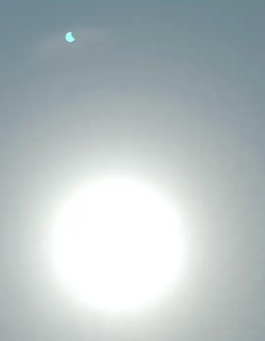

These images are taken from a mobile camera of 21 June 2020 solar eclipse.
So the thing surprising me is there are two objects.
I have shown these images to some people. Some says it's just reflection of sun in camera lenses. And some says the blue object is Venus. But we know if that is Venus then crescent should face the sun.
So I want to know what that light blue crescent object is. And if it is the eclipsed Sun then what is the other bright thing?
First image:
Second image:

The people who say it is an internal reflection are right. This is an internal reflection inside the lens of the camera. There is no actual object there. In particular, Venus is not visible this close to the sun even during a partial solar eclipse. Moreover, Venus is currently a very very thin sliver, no more than a scrape of light at the edge of the planet, and much smaller than this image shows.
It's actually quite nice, because the sun itself is overexposed and the eclipse is not visible, but the internal reflection is exposed quite nicely, and shows the progress of the eclipse well.

  • Is the bright object which is reflection or crescent object? – Usama Jun 21 '20 at 12:17
    The bright object is the highly overexposed sun. The shape of the sun can't be seen. (This kind of shot can actually damage the sensor, it's not designed for that much heat and light.) The blue crescent object is the internal reflection of the sun. – James K Jun 21 '20 at 15:20

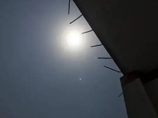

It's an internal reflection. The dead giveaway is that in the second picture, the reflected image is a point reflection at the center of the image optical axis (assuming the image was not cropped).
Using this information, I can predict that the crescent in the actual Sun (which is overexposed), would have the Moon take a bite out of the Sun at the 4 o'clock position (since the reflection has it at the 10 o'clock position).
