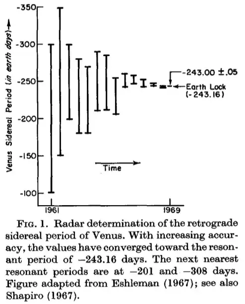

The paper also describes the rapidly evolving studies of Venus by Earth-based radar observation in the 1960's such that by 1969 Venus' apparent synchronicity became obvious at about the same time the Moon landings began. Radar studies of Venus started early, as discussed in
Radar determination of the retrograde sidereal period of Venus
FIG. 1. Radar determination of the retrograde sidereal period of Venus. With increasing accur- acy, the values have converged toward the reson- ant period of --243.16 days. The next nearest resonant periods are at -201 and -308 days. Figure adapted from Eshleman (1967); see also Shapiro (1967).

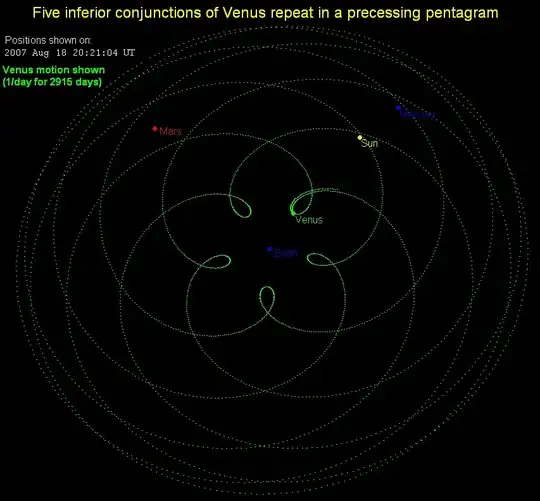

According to Wikipedia, the orbital relationship between Venus and the Earth is coincidental and not because they are locked in a true orbital resonance, but it may be due to a true resonance in the past, or the system may be evolving toward a resonance in the future.
A number of near-integer-ratio relationships between the orbital frequencies of the planets or major moons are sometimes pointed out (see list below). However, these have no dynamical significance because there is no appropriate precession of perihelion or other libration to make the resonance perfect (see the detailed discussion in the section above). Such near resonances are dynamically insignificant even if the mismatch is quite small because (unlike a true resonance), after each cycle the relative position of the bodies shifts. When averaged over astronomically short timescales, their relative position is random, just like bodies that are nowhere near resonance.
For example, consider the orbits of Earth and Venus, which arrive at almost the same configuration after 8 Earth orbits and 13 Venus orbits. The actual ratio is 0.61518624, which is only 0.032% away from exactly 8:13. The mismatch after 8 years is only 1.5° of Venus' orbital movement. Still, this is enough that Venus and Earth find themselves in the opposite relative orientation to the original every 120 such cycles, which is 960 years. Therefore, on timescales of thousands of years or more (still tiny by astronomical standards), their relative position is effectively random.
The presence of a near resonance may reflect that a perfect resonance existed in the past, or that the system is evolving towards one in the future.
Here's a relevant diagram from the same article:
Earth-Venus near-resonance
Depiction of the Earth:Venus 8:13 near resonance. With Earth held stationary at the center of a nonrotating frame, the successive inferior conjunctions of Venus over eight Earth years trace a pentagrammic pattern (reflecting the difference between the numbers in the ratio).

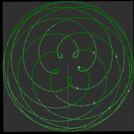

Here's a similar diagram, produced using my 3D orbit plotter script, which is linked at the end of this answer. It covers the timespan between the two most recent transits of Venus, in early June 2004 and 2012, with a 7 day timestep, and 1 year between numeric labels.
Venus relative to Earth

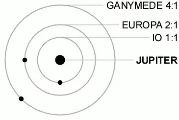

There are several examples of true orbital resonance in the solar system. The most well-known involves the Jovian moons, Ganymede, Europa, and Io.
Galilean moon orbital resonance
The three-body Laplace resonance exhibited by three of Jupiter's Galilean moons. Conjunctions are highlighted by brief color changes. There are two Io-Europa conjunctions (green) and three Io-Ganymede conjunctions (grey) for each Europa-Ganymede conjunction (magenta).
