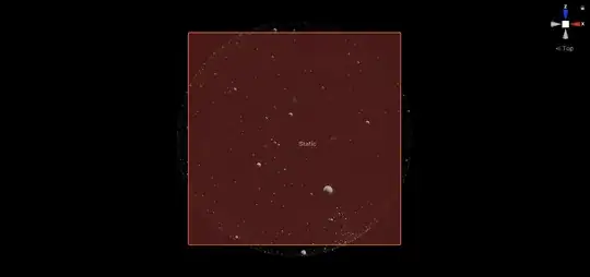

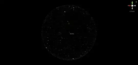

I have plotted stars around the surface of a celestial sphere. At the centre of this sphere, I have a brown plane which is the land. This plane can be rotated in the x,y and z axis.
When x,y,z rotation of the plane is set to 0,0,0:
Front View: Front View
Top View: Top View

After the user inputs the latitude, longitude, time and date, the plane should position itself correctly so that the correct stars are above the plane.
How do I accomplish this and what is the mathematics what links latitude, longitude and the rotation of Earth depending on the time and date to the rotation of the plane in 3-dimensions?
