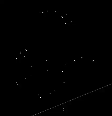

The volumes themselves can quite easily be calculated in Mathematica using the curated data. There is one easy way, which selects what Wolfram Research thinks are the 'bright stars' in each constellation. If you do that, you get
$$\mathrm{Vol}(\mathrm{UMa})=9.20133\times 10^{20}\mathrm{AU}^3, \ \mathrm{Vol}(\mathrm{UMi})=1.7105\times 10^{20}\mathrm{AU}^3$$
which is the volume of the convex hull of the stars shown here:
Mathematica graphics

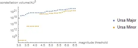

What one should really do is set a threshold magnitude and only count stars brighter than this, and then see the dependence of the volumes on the magnitude threshold. If you do this, you get pretty similar results:
That is, Ursa Major has a consistently higher volume at all naked-eye magnitude thresholds.
For the curious, here's the code.
