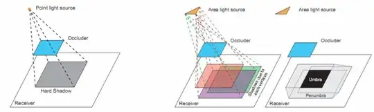

It's due to the larger relative apparent size of the Sun. When the source of light is a point source the shadow is harder, and when it is extended it is softer.
Jupiter is approximately 5 times more distant from the Sun than the Earth, so the Sun is approximately 5 times smaller in the sky.
Hard and soft shadows *Source: University of North Carolina CS

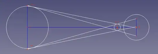

This can be seen geometrically:
Everywhere the lines touch a circle, they are tangent.
In some parts of the shadow, the sun is not visible at all. This is the umbra. It is visible in this construction as the inner cone of the shadow.
Outside this, the sun is only partially obscured. This is called the penumbra.
If the penumbra is small relative to the umbra, the shadow looks hard. If the penumbra is relatively large, the shadow is soft.
Both Io and Earth's moon are about the same size. Both orbit at a similar altitude over their respective bodies, as well. But Io is approximately 5 times more distant from the sun. Accordingly that makes the Sun "smaller" for Io, which according to the geometry above it should be intuitively obvious that the penumbra becomes smaller, and thus, the shadow becomes harder.
If it's not immediately obvious, consider the limiting case where the Sun is just a single point: in that case there is no penumbra at all.
